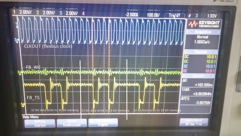

I have 16-bit SRAM connected to K22 via Flexbus. Port size of Flexbus is set to 16-bit. No delays are introduced in write/read cycles (I mean WS/ASET/RDAH/WRAH re all set to 0). This is my configuration:
FB->CS[0].CSCR = FB_CSCR_PS(2)
| FB_CSCR_BLS_MASK
| FB_CSCR_ASET(0x0)
| FB_CSCR_RDAH(0x0)
| FB_CSCR_WRAH(0x0)
| FB_CSCR_AA_MASK
| FB_CSCR_WS(0x0)
I write 32 bit integer into my memory:
volatile int *sram;
sram = SRAM_START_ADDRESS;
sram[0] = 0;
I can see that writing first part of my 32 bit integer takes only 3 flexbus clock cycles. (in the picture you can see three 32 bit integer writes to the 16 bit memory)
In all documents I read flexbus read/write cycles take 4 clock cycles min. Can you please help me in understanding this 3 clock cycle write?

Hi Martin,
I got the feedback from Kinetis product team with below feedback:
In this case, a 32-bit access is launched on a 16-bit port, that means there would definitely be two continuous accesses here.
In fact, S3 is used to terminate the transfer, so in this case, it is reasonable that the 1st access skipped S3 and goes to S0 directly, so it only take 3 clocks here.
But in the second access(it is writing here),  S3 is a must to terminate the transfer.
We have a Flexbus timing about read from 8-bit port size device and write to 16-bit port device with 32-bit access (WS/ASET/RDAH/WRAH re all set to 0).
Please check attached picture for detailed info.
I zoom in the 32-bit write to 16-bit port device and get there take 7 Flexbus clock cycles, the first 16-bit write take 3 Flexbus clock cycles:
Wish it helps.

Hui_Ma
From the scope picture, the write operation with 3 Flexbus cycles.
Could you provide the more detailed Flexbus setting?
What's the SRAM_START_ADDRESS value?
What's the Flexbus clock frequency?
If possible, could you provide Flexbus initialization code?
Thank you.

martindusek
Contributor V
Hi Mike,
my initialization code (I do not post pin function initialization):
#define RAM_START_ADDRESS 0x18000000
void FlexBusInit() {
SIM->SCGC7 |= SIM_SCGC7_FLEXBUS_MASK;
FB->CSPMCR = FB_CSPMCR_GROUP1(2);
FB->CS[0].CSAR = RAM_START_ADDRESS;
| FB_CSCR_BLS_MASK
| FB_CSCR_ASET(0x0)
| FB_CSCR_RDAH(0x0)
| FB_CSCR_WRAH(0x0)
| FB_CSCR_AA_MASK
| FB_CSCR_WS(0x0);
FB->CS[0].CSMR = FB_CSMR_BAM(0x7) | FB_CSMR_V_MASK;
Flexbus clock is 30 MHz, can bee seen on the scope printscreen.

Hui_Ma
From the Flexbus initialization code, there without any issue.
Could you post the Flebux registers value after initialization?
Please make sure there doesn't enable the burst write.
When you do a 16-bit operation, the Flexbus write operation will be 4 cycles?
Thanks.

martindusek
Contributor V
when I perform 16 bit write on 120 MHz CPU frequency:
volatile short *flex = SRAM_START_ADDRESS;
while(1) {
flex[0] = 5;
I can see 4 flexbus clock cycles between every FB_TS assertion on my scope so I guess I can confirm that 16 bit write cycle takes 4 flexbus cycles.
Flexbus registers after initialization:
CSAR0 = 0x18000000
CSMR0 = 0x00070001
CSCR0 = 0x00000380
CSPMCR = 0x20000000
3,979 Views

Hui_Ma
Hi Martin,
Wish it helps.
