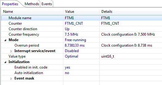

I have a dummy question and couldn't figure out. Hope some one can help me give me an answer.
I created a free running counter FTM1_CNT as follows:
No interrupt, Counting up with period about 8.738 ms
I run the following code: Basically, Initialize, reset counter value to 0, read, delay some time with loops, and read again. Here is the code:

But when I initialize the same counter with the following code (They are the almost same as FC1_Init() by PE:)
I copied from PE generated code into my own initialization function:

But the duration for the same loops are huge different:
#define LOOPS  100000
   for (int i=0; i<LOOPS ; i++ ) {
      volatile int k=9*1107;
d=28329  vs d=40915    :: Why?
I don't know what causes that difference.
Both are configured as
    clock source: system clock:      (01)
     The counter prescaler :  011 (FTM_PDD_DIVIDE_8),
    FTM1_SC = 0xB
    FTM1_MOD = 0xFFFF
But the counter is running at different rate.
What else is different?
Thank you,
David Zhou

davidzhou
Contributor V
Earl and Robin,
Thank your for testing the code for me. I still believe something else causing the issue. I created another timer to measure that first timer, and I printed out all the registers. I found that the SC was different. In the PE the divider is set to 8 (011 binary for PS filed) but it changed to 00 with clock source to external instead of system clock.
One thing confused me is that in my previous project, SC are the same (0xB) for both initialization, but runs at different rate.
OK. I am closing this tick. Thank both of you.
David Zhou
