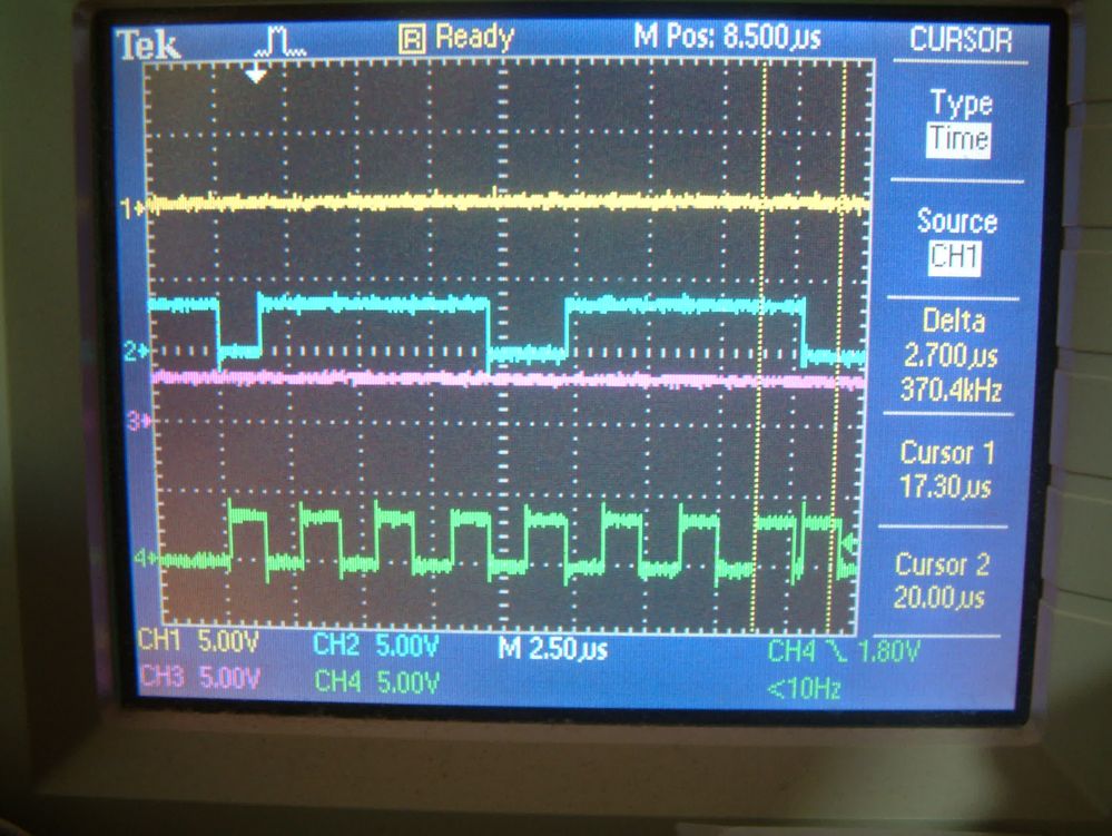

As I mentioned in a previous question, the last bit of a dspi byte transfer is truncated as you can see in this quick and dirty screenshot:
The bottom line is the dspi sck and you can see that the "low" half of the cycle is truncated into the first bit of the next transfer.
The dspi was selected from PE with a clock speed of 375kHz with Clock cfg.4 on a FRDM-k22F board.
I'm looking around and can't find any reason of what I'm doing wrong, 375kHz is a "Possible setting" so I presume that means that the clock is divided evenly (although evidence suggests this is not the case).

It appears you need to add some time before starting the next SPI frame, this is done in the CTAR register through the PCSSCK and CSSCK fields.  That way you can make sure the clock period isn't too short.  Just had to fix this myself on a K10.

Hi David,
Thank you for the pointer - I was able to get the final clock looking pretty good:
A couple of things:
  1. To dynamically read & change the bits of CSSCK & PCSSCK, I found: http://mcuoneclipse.com/2014/05/29/how-to-add-register-details-view-in-eclipse/ which is a plugin & patch that allows register bits to be manipulated from KDS (Eclipse).  I believe CW had/has this capability but it's nice to have it on KDS.
  2. If you look at the waveform above, you'll see the data spikes at the end of the 8th clock cycle high.  Is there any way to remove that?  (It's the purist in me.)
Thanx!
