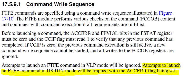

I use the KE processor on the TWR-KE18F board, and I try to write in the flash. I used fluently the C90TFS driver for the K64, without any issues. Now I cannot erase, I get the error 0x20, Access violation.
I used the same settings as in the K64, it seems they are compatible in terms of the fields in the FLASH_SSD_CONFIG structure, the difference is the ability of the FLEXNVM which I am not interested on.
But no way to have it working. I tested also the example and nothing.
I need a suggestion.

Are you using the KE18F in HSRUN mode because Flash operations can't be performed in this mode:

You are right.
Now it is fine,,,
