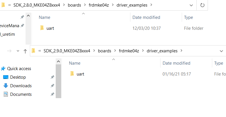

       I am using MKE04Z microcontroller and SDK(SDK_2.9.0_MKE04Z8xxx4) . Is there any example how to use fsl_flash.c for this sdk. I saw pflash.c for the other microcontrollers but I think they use different sdk with different functions and parameters. Thank you.

kerryzhou
Hi okaner,
  Can't you find the pflash demo from this link:
SDK_2.9.0_FRDM-KE04Z\boards\frdmke04z\driver_examples\flash\pflash
At lease, in the SDK 2.8.0, I still can find the pflash project, please check your SDK folder, whether you have that project or not?
If you still have issues about it, please kindly let me know.
Kerry
5,104 Views
okaner
Hi Kerry,
     I have only uart example for both versions of SDK. In SDK Builder application, if I select filter for pflash.c example, in next step I cannot select Kinetis E series.
