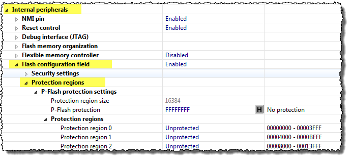

I made the last section of my PFLASH0 to be protected:

Yes, with the GUI is easier to protect your flash.
