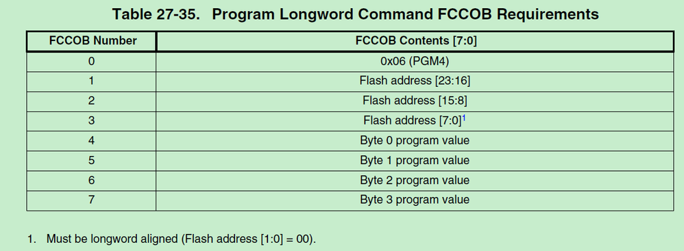

Hui_Ma
I don't receive any bug report about MCUXpresso SDK flash driver.
Please check below table, the Flash address must be longword aligned (Flash address[1:0] = 00).
And what's the result value when you called the FLASH_Program() function?
result = FLASH_Program(&s_flashDriver, destAdrss, s_buffer, sizeof(s_buffer));

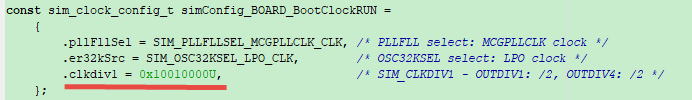

Hui_Ma
Hi Shrek,
I think the below code with the issue to set Bus clock & Flash clock to 24MHz:
The correct clkdiv1 should be: 0x10030000U.
Could you try that setting with KL15 chip?
