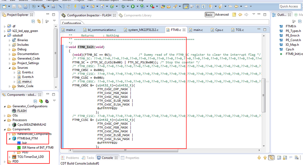

HI All,
I am using SKEAZN64MLC controller in my project,
Now i need to implement some timer logic for my requirement.
I need to keep on count the timer count value, once counter value greater than some predefined value , then i need to stop timer.
and again start the timer by count value initializing to 0.
1. How to start and stop flex timer?.
2. How to initialize the timer to count for 1 us.?.

Hello ,
Which IDE do you use ?
If you use KDS, i recommend you create one PE project , then add the "Init_FTM" component or "TimerOut_LDD" component ,
then generate code ,  you can find the configuration about the FTM.
Hope it helps
Alice

Hello ,
Call the function spi_init() ???
If you want use the flex timer , please add the component of "Init_FTM" or "TimerOut_LDD",
then configure it , then click generate code button here :
then you can fund the generated code here :
If still have any question, please send your project to me . I use KDS3.0 .
Hope it helps
Alice
