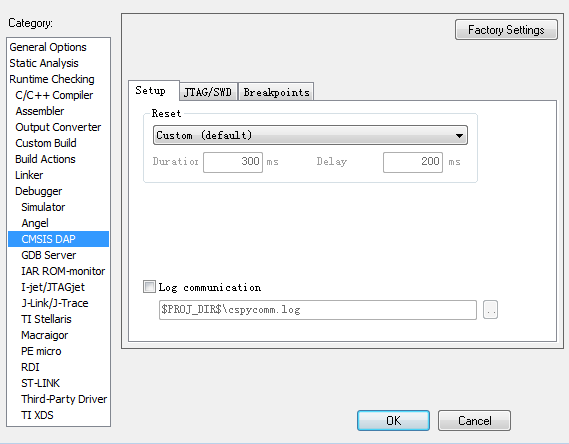

I am using Kw24d512,  IAR EWARM Evaluation version 30 days.
When I try to flash the program using CMSIS-DAP, there is one error happened. I am new to this trip. any methods or infos help would be appreciated.
Error info:
Fri Jan 29, 2016 17:21:48: Loaded macro file: C:\Program Files (x86)\IAR Systems\Embedded Workbench 7.3\arm\config\debugger\Freescale\KW2xD.dmac
Fri Jan 29, 2016 17:21:48: Loading the CMSIS-DAP driver
Fri Jan 29, 2016 17:21:48: Probe: CMSIS-DAP probe SW module ver 1.11
Fri Jan 29, 2016 17:21:48: Probe: CMSIS-DAP S/N '03200203528E6E48AF729290' mapped to a number 729290.
Fri Jan 29, 2016 17:21:48: EARM v.3.96
Fri Jan 29, 2016 17:21:48: Emulation layer version 3.96
Fri Jan 29, 2016 17:21:48: Notification to core-connect hookup.
Fri Jan 29, 2016 17:21:48: MDM-AP detected
Fri Jan 29, 2016 17:21:48: Probe: ConnectSpec='MBED CMSIS-DAP:03200203528E6E48AF729290:8-2F6F56D7-0-0000'.
Fri Jan 29, 2016 17:21:49: Connecting to TAP#0 DAP AHB-AP-CM port 0 (IDR=0x24770011).
Fri Jan 29, 2016 17:21:49: Recognized CPUID=0x410fc241 Cortex-M4 r0p1 arch ARMv7-M
Fri Jan 29, 2016 17:21:49: Debug resources: 6 instruction comparators, 4 data watchpoints.
Fri Jan 29, 2016 17:21:49: CPU status OK
Fri Jan 29, 2016 17:21:49: LowLevelReset(script, delay 200)
Fri Jan 29, 2016 17:21:49: Calling reset script: ResetAndDisableWatchdog
Fri Jan 29, 2016 17:21:49: CMD_INTERPRETER: failed

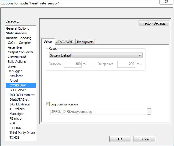

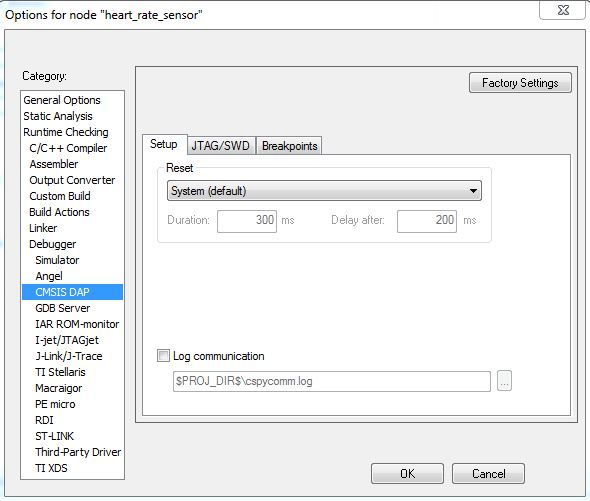

Thank you very much for your response Ramón.
I'd like to translate it for further reference in the future.
In IAR it is necessary to change the configuration, you just need to click in main menu on Project tab then follow Options... or Alt + F7:
You'll see the next window and you have to select as follows In Category < Debugger (CMSIS DAP) < Septup < Reset.
Then you have to select the option System (Default) then click OK.
You should download again and the problem should be fixed.
I hope this information helps.

taodong
I am now using the FRDMKW24-512 and met the belowing problem:
Wed Jun 15, 2016 12:03:56: C:\Program Files (x86)\IAR Systems\Embedded Workbench 7.2\arm\config\debugger\Freescale\KW2xD.dmac(103,17): Error: Operation error.
Wed Jun 15, 2016 12:03:56: Error while calling macro execUserCoreConnect
Wed Jun 15, 2016 12:03:56: CMD_INTERPRETER: failed
And I have tried the reset options (custom software hardware system core ),all of those could not solve the problem.
My IAR version is 7.40.3.8938

Por fin encontre la solucion a este problema.
en el compilador iar cambiar la configuracion en option < Debugger < CMSIS DAP < septup< Reset en este lugar cambiar la opcion a  System(default) como se muestra en la imagen .descarga de nuevo tu ejemplo y asunto arreglado.

franciscomezana

dapenglan
Thank you very much. I solved the problems.
But I changed the Reset mode to [Software reset] rather than system (default), and it works.
