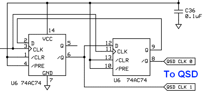

Hi. I implemented an VRZ for my K21 with PHA and PHB.
But now I need a counter, which counting up/down when PHA is high or on rising / falling edge. I have only one phase (PHA).
I sampled it with the quadrature mode, but I think this is the wrong way.
Is there an other solution, how I can use the PHA to increment/decrement my counter?
When I use the normal FTM up counting mode my counter counting but not in the mercy of my PHA?
Have anybody an idea?
rgds Oliver

Quadrature-mode requires interleaved edges on BOTH PHA and PHB to count -- the direction being defined by the interplay of 'high'/'low' 'rising'/falling' on both inputs.  Toggling just one input will simply make the counter go 'up' and 'down' 1 count on successive edges.
You don't explain further how you want to define whether you count 'up' or 'down' on any given edge of your 'clock'.  If you generally just want 'one way or the other' you simply select an external clock for the FTM in question and supply your signal to such external-clock-capable pin.  FTM will then count 'up' on one of 'rising' or 'falling' edges, and you can programmatically compute counts in an interval as 'one way or the other'.  If you want to supply a faster, externally-defined understanding of 'up' vs. 'down' you will have to build a bit of external hardware that will convert 'count & direction' into the 'PHA/PHB' sequence.
This will make rising-edges into quadrature:
Direction control can be implemented by letting it control a pair of 2to1 muxes that select either these /Q, Q feedback points OR their inverse (Q, /Q) (or exclusive-or gates).
