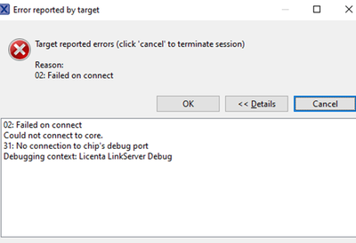

I am using FRDM KE16Z for project everything worked fine with debug but no it give me this erro. I tried changing the port and the cable. I didn t changed any jumper or anything else.

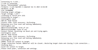

I tried to put JLINK Open SDA and it doesn t work either.

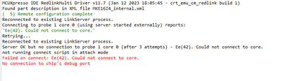

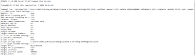

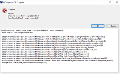

I know there is erase flash action but it doesn t work. It gives me the same error. I will attach here img with all the error i get.

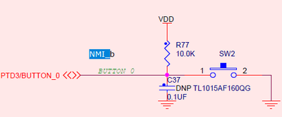

Pavel_Hernandez
Hello, thanks for being clear, I understand now, so It's seeming like the debug cannot access to the MCU, could you try with the NMI SW1 down?
Then use the GUI.
Pavel

Pavel_Hernandez
Hello, my name is Pavel, and I will be supporting your case, the image you attach looks like the debug probe works fine but this does not find the MCU maybe this is in an unknown state, I recommend doing an erase of a flash.
You could try these options depending on the firmware of your debug probe and try the "erase flash action" option.
