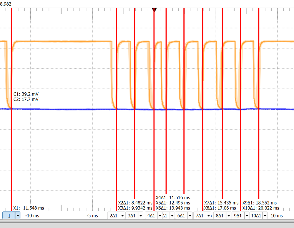

I am using FTM2 in dual edge input capture mode.
FTM2 running on 187500Hz frequency clock.
The PPM signal i am trying to capture is attached.
I am getting some negative numbers sporadically, more frequent when running higher FTM2 clock frequency. But it has a pattern, in the middle of the "overflow" value (65535/2 = 32768) when running 187500Hz FTM clock.
I suspect it is related to an overflow interrupt(s) is/are skipped, have debugged in two days without figuring out the cause of this glitch.
The source code is based on SDK example frdmk64f_ftm_dual_edge_capture with modifications, and is attached.
I appreciate the help and the time consumed to answer this thread!

Because you use only the rising edge as a capture signal, I suggest you use single edge capture mode(normal input capture mode) mode and the code will become simple.
void FTM_INPUT_CAPTURE_HANDLER(void)
if ((FTM_GetStatusFlags(DEMO_FTM_BASEADDR) & kFTM_TimeOverflowFlag) == kFTM_TimeOverflowFlag)
/* Clear overflow interrupt flag.*/
FTM_ClearStatusFlags(DEMO_FTM_BASEADDR, kFTM_TimeOverflowFlag);
g_timerOverflowInterruptCount++;
else if (((FTM_GetStatusFlags(DEMO_FTM_BASEADDR) & FTM_FIRST_CHANNEL_FLAG) == FTM_FIRST_CHANNEL_FLAG))
/* Disable first channel interrupt.*/
FTM_ClearStatusFlags(DEMO_FTM_BASEADDR, FTM_FIRST_CHANNEL_FLAG);
capture1Val = FTM_GetInputCaptureValue(DEMO_FTM_BASEADDR, (ftm_chnl_t)(BOARD_FTM_INPUT_CAPTURE_CHANNEL));
period=g_timerOverflowInterruptCount*(FTM_MOD&0xFFFF)+capture1Val-capture1Val_Prev;
capture1Val_Prev=capture1Val;
If you do want to use dual-capture mode, I suggest you disable the first channel interrupt, in this mode, only the second edge generate interrupt.
Hope it can help you
