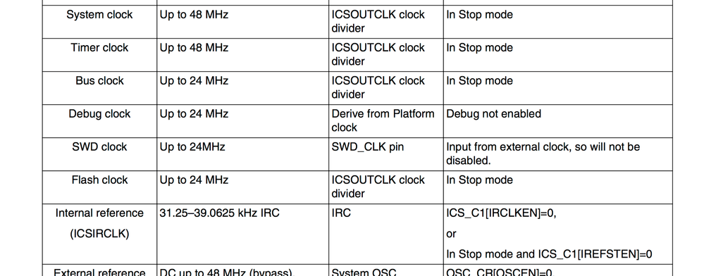

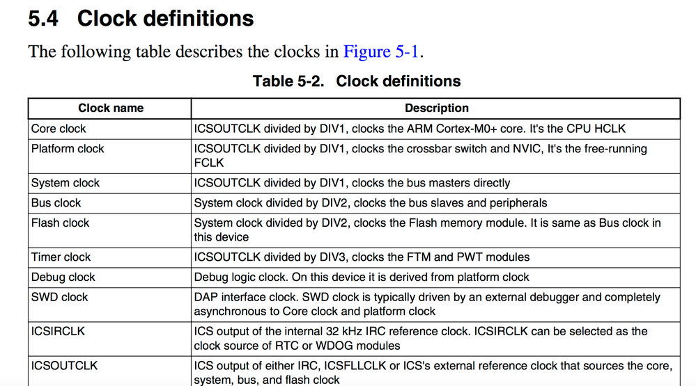

pascalschröer
Contributor V
Have a look:
First step of starting an embedded system is to initialize your clocks!
Cheers,
Pascal

xiangjun_rong
Hi, all,
Regarding the FTM driving clock, it is dependent on the FTM  clock source and prescaler, in other words, the FTM driving clock frequency equals to (FTM clock source frequency)/Prescaler.
The CLKS bits in FTM_SC register determines the FTM clock source for KEA128 chip:
CLKS bits                        clock source
00                                   FTM disabled
01                                  system clock source
10                                  Fixed frequency clock
11                                  External clock source
Pls refer to Figure 5-3. FTM and PWT clock generation in the KEA128RM.pdf for the detailed FTM clock source.
When the CLKS=01, the system clock source is selected, in the condition, the ICSOUTCLK clock source divided by DIV3 is used as FTM clock source, DIV3 bits is specified in SIM_CLKDIV. Pls refer to the Figure 5-1. Clocking diagram in KEA128RM.pdf.
when the CLKS=10, the ICSFFCLK clcok source is selected as FTM clock source, ICSFFCLK clock source is 37.5KHz IRC or (external OSC)/RDIV, pls refer to Figure 5-1. Clocking diagram.
when the CLKS=11, the FTM clcok source are from TCLK0/TCLK1/TCLK2 pins, SIM_PINSEL0[FTM0CLKPS] select the clock source pins from the three pins. Note TCLK0/TCLK1/TCLK2 are Kea128 external signal pads, for example:
This is the pin assignment of TCLK0 pin.
79(79 LQFP) 63(63 LQFP) PTA5, RESET_b, PTA5 KBI0_P5, IRQ, TCLK0, RESET_b
In otherwords, you can connect the external clock source to the TCLK0 pin, the FTM driving clock frequency will be (TCLK0 Pin clock frequency)/Prescaler, the prescaler is defined in the FTM_SC register.
Note you should enable the FTM  gate clock by setting the corresponding bit in SIM_SCGC register when you use CLKS=01 setting..
