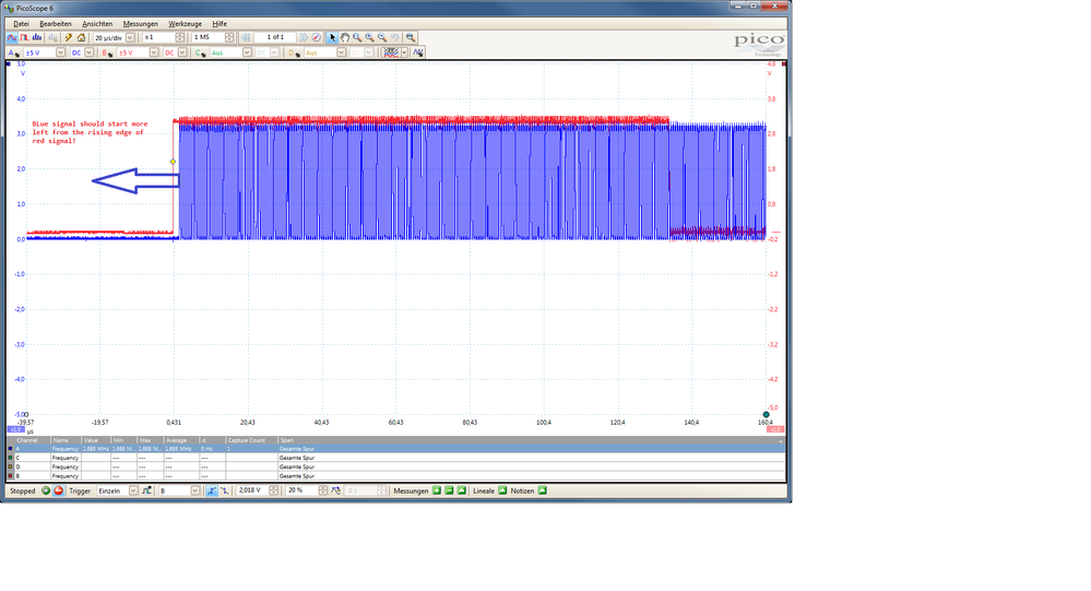

I have written an driver that generates 2 digital signals with FTM.
Blue signal has a frequency with 1.6 MHz and is generated with FTM0.
Red signal has a frequency with 750 Hz and is generated with FTM1.
Both FTM instances are synchronized with the global time base (GTB).
So it works fine.
But there is a problem on starting signals (picture below).
The blue signal should be start (user defined time) earlier as the red signal!
I have tried a lot, e.g. start PWM instance (FTM1) for red signal later (with sleep 1msec) as the blue signal on FTM0.
Or enable the specified channel later...
But the main problem is the enabling of GTB, because the signals are switched on (almost) simultaneously if GTB is enabled (so as in the picture above).
And if the GTB is enabled then some register values can no more be written because there are locked.
Is there a way to solve this problem?
Thanks in advance!

Hi, Frank,
I think it is okay to have blue signal appear before the rising edge of red signal. This is my idea. As you know that the FTM0/FTM1 counter will start simultaneously with the global time base (GTB), we can use the different mode to implement that the blue signal appear before the red signal.
we can set both FTM0/FTM1 in edge alignment mode, while set the blue signal(FTM0) in edge-alignment and High-true pulses(clear Output on match) mode, in this way, the blue signal will rise when the FTM0 counter is zero. Pls refer to section 42.3.6 Channel (n) Status And Control (FTMx_CnSC) in RM of Kinetis.
we can set the red signal(FTM1) in edge-alignment, low-true pulses(set output on match) and combined mode, in combined mode, the red signal waveform is low-High-low, the rising edge instant is controlled by C0V register, the falling edge is controlled by C1V register if the red signal is outputted from FTM1_CH0. in this way, if we set appropriate value for the FTM1_C0V(the delay clock number),  the blue signal will appear before the red signal although the FTM0/FTM1 synchronize.
Note that if you use combined mode, the FTM1_CH0/FTM1_CH1 should be in complementary mode.
Hope it can help you.
