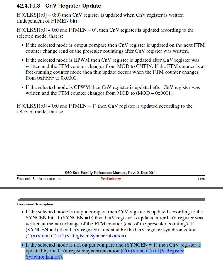

Hello
I'm on a K60 and test to generate pulse to drive stepper motor.
I have a working code which can generate a pulse of a determined wide and period. (CNTIN; MOD  / CnV; C(n+1)V)
Then with the following code I generate a square signal (CNTIN = 0, MOD = 65535, Cnv = 1, Cn+1V = 0x8000)
SIM->SCGC6 |= SIM_SCGC6_FTM0_MASK; FTM0->MODE = FTM_MODE_WPDIS_MASK | FTM_MODE_INIT_MASK ;  /* Set up mode register */ FTM0->MODE |= FTM_MODE_FTMEN_MASK;  /* FTMEN bit is write protected. Can be written only when WPDIS = 1 */ FTM0->SC = (uint32_t)0x00UL;  /* Clear status and control register */ FTM0->CNTIN= (uint32_t)0x00UL;  /* Clear counter initial register */ FTM0->MOD = (uint32_t)(DV_PWM_MODULO-1);  /* Set up modulo register */ FTM0->CNT = (uint32_t)0x00UL;  /* Reset counter register */ FTM0->CONTROLS[0].CnSC = FTM_CnSC_ELSB_MASK;  FTM0->CONTROLS[1].CnSC = FTM_CnSC_CHIE_MASK;  FTM0->COMBINE = FTM_COMBINE_COMBINE0_MASK;  FTM0->CONTROLS[0].CnV= 1/* Allow to modify pulse start */ FTM0->CONTROLS[1].CnV = 0x8000/* Allow to modify Pulse end */   PORTC->PCR[1]= PORT_PCR_MUX(4); FTM0->SC= (uint32_t)(/* //debug AG FTM_SC_TOIE_MASK |*/ FTM_SC_CLKS(1) | FTM_SC_PS(DV_PWM_PRESCALER));  /* Set up status and control register */
To test some possibility, I just configure the CHn+1IE and Flag to generate the interrupt on Falling edge (Cn+1V = FTM Counter)
void __attribute__ ((interrupt)) DV_Pwm_FTM0IRQ(void) { /* Toggle port debug */ PTC->PTOR |= 0x00000001; /* Increment Cn+1V */ FTM0->CONTROLS[1].CnV++; FTM0->CONTROLS[1].CnSC &= ~FTM_CnSC_CHF_MASK; // clear flag }
But after test, IT occurs because My debug Pin on PTC0  toggle.
But the Cn+1V which is incremented on the Interrupt has no effect on my output signal which should pass from a initial duty cycle of 50% to 100% and then 0%  to 100% etc...
But signal still 50% duty!.
SYNCEN is set to 0,
so I don't see why Cn+1V is not impacted?
Smiley Happy
I read the RM, But I think the Update register should be OK because SYNCEN = 0 & SYNCMODE = 0):

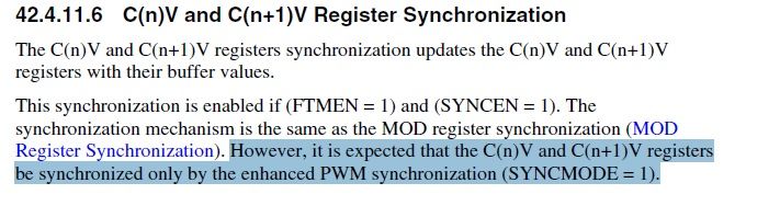

Hi Arno,
I think you will find that if you FTMEN = 1, you must load the CnV registers according to the PWM Synchronization rules.  Meaning that you will need to set the SYNCEN bit in the Combine register and then setup the synchronization according to how you want to synchronize the registers.  Here is a snippet of code that will set up your FTM for software synchronization:
FTM0_COMBINE |= FTM_COMBINE_SYNCEN0_MASK;
        FTM0_SYNCONF |= (FTM_SYNCONF_SWWRBUF_MASK |
                        FTM_SYNCONF_SWRSTCNT_MASK |
                        FTM_SYNCONF_SYNCMODE_MASK
This should be inserted in your setup code.  Once you have this configuration, remember to add a write to the SWSYNC bit after writing your CnV register in your interrupt routine. This write triggers the load of the CnV registers so that they take effect.
FTM0_SYNC |= FTM_SYNC_SWSYNC_MASK;
There are other ways to control how the registers are loaded when you have FTMEN = 1, but I think this is the simplest fastest method for you at this point.  Please let me know if you are interested in other ways or if you have any other questions about this method.

I have another problem.
By the way explain above, CnV anc Cn+1V (Refresh in Cn+1V IT) are updated on the FTM counter pass from High value (0xFFFF) to low value (0x0000)
But in my case, I want in the Cn+1V refresh CnV and Cn+1V and taken immediately in the same FTM cycle, Not wait end of Counter reach max value (MOD), but immediately and then if new CnV / Cn+1V match TMR counter value, modify output and then generate interrupt..
Is there possible with the FTM?
