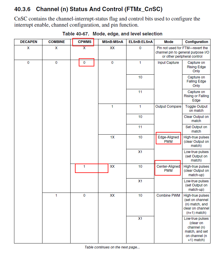

Hi everyone,
i am trying to create a Center aligned PWM complementary signals en the FRDM-K64F using KDS.
My conditions must be:
Normal          complementary
FTM0_CH0 - FTM0_CH1
FTM0_CH1 - FTM0_CH2
FTM0_CH6 - FTM0_CH7
in the reference manual of K64P144M (40.4.9 Complementary mode) there the next conditions.
FTMEN = 1, QUADEN = 0, DECAPEN = 0, COMBINE = 1, CPWMS = 0, and COMP = 1.
I initialized the registers but i have not nothing in the output channel, it supposed that the values of the CnV register are the value reading with the ADC channel.
Can sombody help me please??
This is my code..

Hello Alonso  ,
About the PWM mode , please refer to here :
From your describe ""create a Center aligned PWM complementary signals" , while "CPWMS = 0," , it should be "1".
Please refer to the table to check your other configuration.
And recommend you some k64 PWM demo :
FRDM-K64 PWM basic example using mbed
Baremetal code examples using FRDM-K64F
Alice
