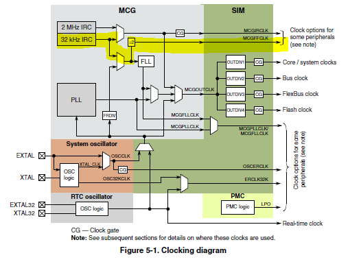

I need a free run timer ticking milliseconds.
FTM clocked from the System clock (120Mhz)  and the prescalers I have 1 - 128. So I can not get 1 millisecond tick.
Is there any way to do it?
As I see we have another option in CLKS - Fixed frequency clock. How do I configure this option?

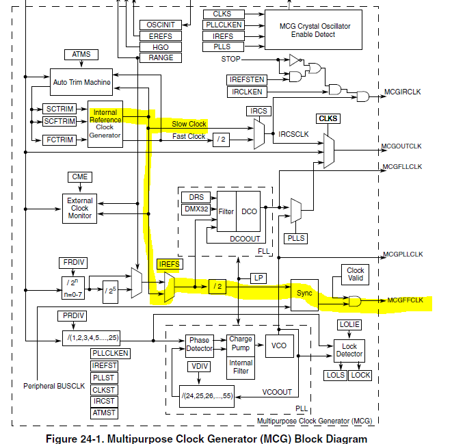

mjbcswitzerland
Specialist V
Evgeny
All you need to do is set IREFS in MCG_C1. Note that there is a divide by 2 in the path!
If you don't set this it will use the external clock (divided by FRDIV) which gives a more accurate/stable reference but may not allow 32kHz unless the clock happens to be a multiple of it.
Mark

mjbcswitzerland
Specialist V
The fixed clock option depends on the Kinetsi part being used - it is often the MCGFFCK and so can be set to the 32kHz IRC, which allows you to use a 32 prescaler to derive a 1ms counting rate (although the 32kHz IRC clock has some tolerance).
It can be selected in the CLKS field of the FTMx_SC register.
Mark

mjbcswitzerland
Specialist V
Evgeny
K10:
Mark

john71
Senior Contributor I
So if choose CLKS = 10 - Fixed frequency clock - MCGFFCLK will be routed as  FTM clock source?
5,689 Views
mjbcswitzerland
Specialist V
Yes.
