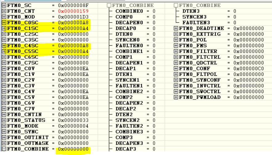

It generates 1kHz PWM 50% complimentary signals on PTC1, PTC2 and PTD4, PTD5, whereby the CH0,1 and CH4,5 are 45° phase shifted [binary attached]
This is a snap-shot of the FTM0 registers so that you can compare with yours.
Note that to get complimentary outputs on a channel pair the COMP0 flag needs to be set. Since it is possible to do the non-shifted channels in non-combined mode I have set up the first 2 independently but one phase reversed (using MS_ELS_PWM_LOW_TRUE_PULSES channel setting instead) but could have used combined mode to do the same. CH4/5 (the ones you are interested in) are in combined/complimentary mode.

If you don't set the COMBINE mode you are not pairing the channels (they are all independent) and so the other control bits will do nothing (or maybe have strange effects).
If you are programming at the low level (rather than using decent HAL/APIs that do the detailed work) you will need to understand the workings by reading the following and experimenting until all is fully clear: https://www.nxp.com/docs/en/application-note/AN5142.pdf
In case you don't actually need to pair the channels (not needed if not shifting or inserting dead-time, etc.) you can invert the output in its dedicated channel control register by using "Low-True Pulses" rather than "High-True Pulses":
This is what I explained as the way I did it on the first two channels; whilst I showed the COMBINE method on the second two channels (which are then paired) and can be phase shifted.
Note that the 0xa4 has inverted output to 0xa8 due to the setting detailed in the user's manual's table. Change these bits in the channel you want to have inverted and then it will probably work.

Channels are only paired when you combine them, otherwise they are independent - this is true for all Kinetis parts with FlexTimers or TMPs. If they are not behaving like this you must be setting something incorrectly or making a measurement mistake.
I changed the code to remove the PHASE_SHIFT (which is what is used to decide whether to use normal or combined mode) and have rebuild the FRDM-K82F binary (attached). Now it operates without the 45° phase shift and all 4 channels are independent.
Again I can show you the register content to do this - you will need to investigate all register details to work out what you are doing differently to explain the complications.
