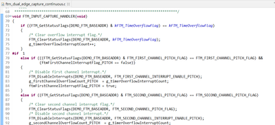

FTM0 channel pair 0 uses channels 0 and 1, channel pair 1 uses channels 2 and 3, but  capture of pwm input will cause program instability. Is the way to enable and disable interrupts incorrect?

Hi Eric,
Thank you for your reply. I see you are using ftm_dual_edge_capture example from the SDK as a starting point. Is there an issue if you run example code with no modifications? Could you please provide what did you modify in the example? This will help us narrow down where the issue could be.
Additionally, could you please let me know what specific line of your code is the MCU halting?
Felipe

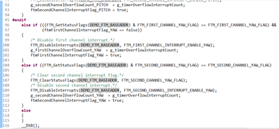

erichsu

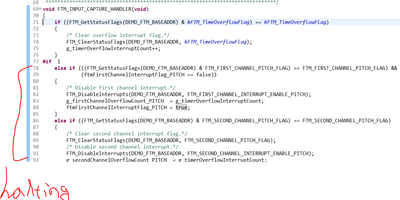

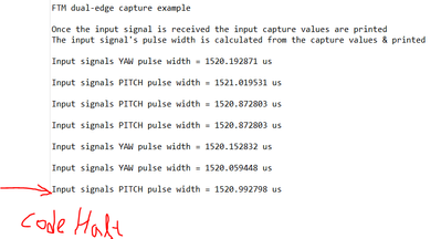

Ans: Halting

FelipeGarcia
Hi Eric,
I would recommend to try to implement this step by step, have you tried to change the example to use channel 0 and 1 before incrementing to 4 channels? If this work then it could be an issue of interrupt management, if this does not work then it could be a configuration issue.
Felipe
