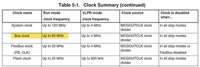

First thing here that caught my attention here is that you are exceeding the bus clock maximum frequency. Please check the table below from the reference manual.
Please try to use bus clock withing the allowed range. I think this could be the main issue of the incorrect frequency you are measuring.

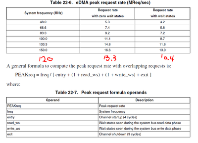

at first I thought it's eDMA performance issue, but according to description of eDMA : chapter 22.4.4.3
“For an internal peripheral bus to SRAM transfer, PEAKreq = 150 MHz / [ 4 + (1 + 2) + (1 + 1) + 3 ] cycles = 12.5 Mreq/sec
The example system operates at 150MHz, and our system operates at 120MHz, so the PEAKreq should be 10Mreq/sec
therefore my understanding is : eDMA should not affect the result when the input signal frequency below 10MHz, did my understanding correct?

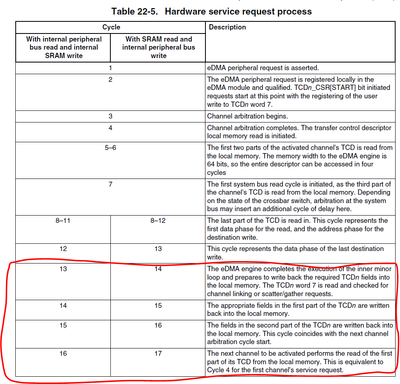

  • And then Second interrupt been generated before eDMA finish current round, therefore Second interrupt been ignored ( interrupt happend between cycle 13-16 / 14-17)
  • And then Third interrupt been generated to kick eDMA start second round ....
Therefore the calculated result been halved.
But, it is inconsistent with the description in the user manual if my suspicion is correct. eDMA performance should able to process 10M request when system frequency is 120MHz
and FTM input capture mode could generated interrupt correctly when input frequency below 15MHz.
So I don't know which module has slow down the system... that makes me confused. could you give me some help.
