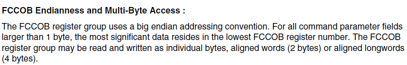

The datasheet for the MK10DX256VLH7 states that the Program LongWord command will program FCCOB4 to FCCOB7 to addresses n to n+3, but when I check it, the word written has the bytes swapped.
It means I have to program:
enum { FTFL_ProgramLongWord = 0x06};
void programWord( int address, uint32_t value)
  FTFL_BASE_PTR->FCCOB0 = FTFL_ProgramLongWord;
  FTFL_BASE_PTR->FCCOB1 = address >> 16;
  FTFL_BASE_PTR->FCCOB2 = address >>  8;
  FTFL_BASE_PTR->FCCOB3 = address >>  0;
  FTFL_BASE_PTR->FCCOB4 = value >> 24;
  FTFL_BASE_PTR->FCCOB5 = value >> 16;
  FTFL_BASE_PTR->FCCOB6 = value >>  8;
  FTFL_BASE_PTR->FCCOB7 = value >>  0;
  // start command and wait for completion
Digging deeper, I noticed as well the definition in KM10D7.h, which has a byte swapped ordered FCCOB declaration, contradicting the order described in the datasheet.

Which means that one could do the programming of a long word as follows:
typedef struct FTFL_WordMap {
int  :32;
  uint32_t FCCOB_3_0;
  uint32_t FCCOB_7_4;
  uint32_t FCCOB_B_8;
  int :32;
  int :32;
} volatile *FTFL_WordMapPtr;
FTFL_WordMapPtr* pWordBase = (FTFL_WordMapPtr) FTFL_BASE_PTR;
pWordBase->FCCOB_3_0 = FTFL_ProgramLongWord << 24 | ( address & ( ( 1<<24) - 1));
pWordBase->FCCOB_7_4 = value;
Do these issues extend to all Kinetis processors utilizing the FTFL or FTFE flash module?

The old version (vBeta033) FTFL Programlongword driver with below info, which according to Kinetis product Endianness select FCCOB[4~7] data.
Please check below code:
/* check for error return code */
if(FTFx_OK == returnCode)
   while(size > 0)
       /* preparing passing parameter to program the flash block */
       pCommandArray[0] = FTFx_PROGRAM_LONGWORD;
       pCommandArray[1] = (UINT8)(destination >> 16);
       pCommandArray[2] = (UINT8)((destination >> 8) & 0xFF);
       pCommandArray[3] = (UINT8)(destination & 0xFF);
#if (ENDIANNESS == BIG_ENDIAN)  /* Big Endian */
       pCommandArray[4] = READ8(source);
       pCommandArray[5] = READ8(source + 1);
       pCommandArray[6] = READ8(source + 2);
       pCommandArray[7] = READ8(source + 3);
#else /* Little Endian */
       pCommandArray[4] = READ8(source + 3);
       pCommandArray[5] = READ8(source + 2);
       pCommandArray[6] = READ8(source + 1);
       pCommandArray[7] = READ8(source);
#endif
I also attached the whole FTFL Programlongword driver for your reference.

This may be correct but also confusing. The FCCOB register bytes are implemented in little-endian storage which then swaps it around again. On the other hand it may also be wrong and it should state that it uses a little-endian addressing convention(?).
In any case the flash controllers in all parts is the same in this respect, so it is always possible to write a long word directly when addressing the FCCOB registers as long words (like FTFL_FCCOB7_4) as you have done.
