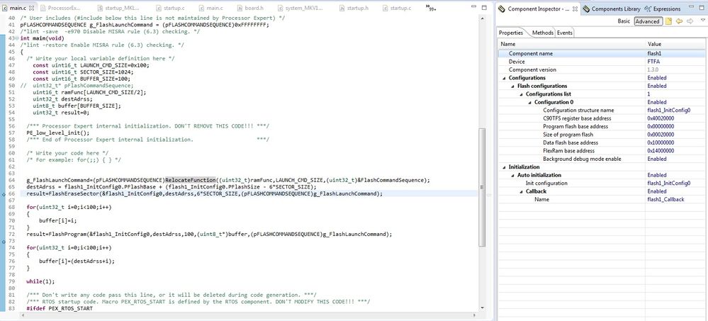

HI!
I am trying to save some data to Flash. For practice I am using frdm kl43 board but the final product will be on kv10. So the decision not to use FlexNVM functionality but ordinary flash module functionality. I am trying to follow example but with PE. My main and PE is here:
(main also attached)
Debugging the code i get to

Hello Alexey Usoltsev:
I guess this is caused by SysTick interrupt firing. The interrupt handler is in the same flash block and it leads to a "Read-while-write error".
- Try setting the OSA timer to None as discussed in the next thread:
Guidance on fsl_flash Processor Expert component usage
- Or enable the ESFC bit as explained in the next discussion:
Writing flash memory with KL27Z256
Let me know it the problem is not solved.

alexeyusoltsev
Hello again Jorge Gonzalez,
I am a bit confused a bit MCM_PLACAR ESFC bit.
I am setting ESFC bit by MCM_PLACR_ESFC(1); but if one let global interrupts be enabled it still fails. If interrupts are desabled erase-write goes "ok".
Alexey.
3,106 Views
alexeyusoltsev
Hello Jorge Gonzalez,
It worked out!!! Many thanks. And the info about arbitration using is very helpful too!

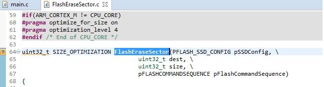

alexeyusoltsev
  I've launched example successfully. But in my programm when pressing F3 on erase function one can see error:
may be I have to compile C90TFS lib elsewhere?
