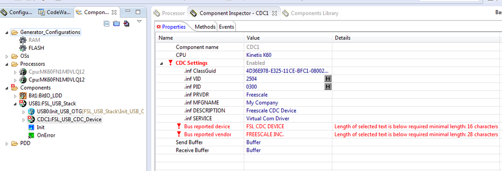

Hello Everyone,
I am facing an unusual problem with the custom component created by Mr Erich Styger. Link -> FSL_USB_Stack
I am using a MK60FN1MOV with CW 10.6.
I am able to use the component normally,but when ever i close the project and re-open it again ,i get this error in the CDC component.
Its very frustrating to delete the "FSL_USB_STACK" components and again add it,whenever i open my project.
Is there a way around this?
Thanks in Advance
Arun

This is a known bug/issue in Processor Expert, and shortly after that MCU10.6 update came out, a workaround has been added to the FSL_USB_Stack component.
That you see this problem let me think that you are not using the latest components.
Are you using the latest version from SourceForge (McuOnEclipse - Browse /PEx Components at SourceForge.net, latest release right now is from 27-Dec-2014).
See McuOnEclipse Releases on SourceForge | MCU on Eclipse how to download/install them.
I hope this helps,
Erich

Hello Erich,
Yes that did the trick, I downloaded the latest PEx components and now the CDC component module is not giving that error.
Thank you,
