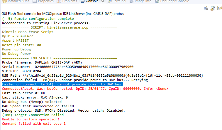

I know this topic has been revised over and over, but still cant make it work.
Im usin mcuXpresso IDE.
Board was working fine until some code i made seem to broke it.
When trying to debug the board, it appears this message:
0 available SWD Devices detected.
Connect a device and try again.
Ive tried changing the K20  bootloader on the on the board. Tried openSDA 2.2 and also DAPLINK. None of them worked.
Also tried Mass Erase option from the GUI Flash Tool and Ressurect Locked Device. Both options returned with error.
Please find attached the console when tried the Ressurect Locked Device action.
Is there anything i can make without using another board/programmer to program it? Maybe a flash erase by using some combination of jumpers?

Did you change some pins?
This link has similar issue , I hope it help you.
https://community.nxp.com/t5/Kinetis-Microcontrollers/FRDM-Mke15z-in-MCUXpresso-IDE/td-p/1205300

It worked!
You dont know how greatfull i am to you.
Solved by pressin the SW3 while debuggin/programmin

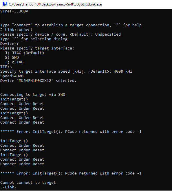

Tried J-LINK bootloader binary image. Loadded succesfully. When tried to connect with J-Link, it returned error Dap error2.png
