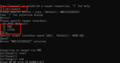

12,167 Views
nxf58904
If your opensda's firmware is not jlink, you need an external jlink.
Please have a try .
I hope this help you .
TIC
12,166 Views
nxf58904

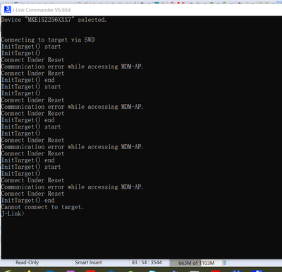

Shaanu
I have used openSDA firmware jlink,I found below error, please help on it.
SEGGER J-Link Commander V6.86 (Compiled Sep 24 2020 17:33:12)
DLL version V6.86, compiled Sep 24 2020 17:31:31
Connecting to J-Link via USB...O.K.
Firmware: J-Link OpenSDA 2 compiled May 27 2019 11:01:03
Hardware version: V1.00
S/N: 621000000
VTref=3.300V
Type "connect" to establish a target connection, '?' for help
J-Link>connect
Please specify device / core. <Default>: MKE15Z256XXX7
Type '?' for selection dialog
Device>
Please specify target interface:
J) JTAG (Default)
S) SWD
T) cJTAG
TIF>s
Specify target interface speed [kHz]. <Default>: 4000 kHz
Speed>
Device "MKE15Z256XXX7" selected.
Connecting to target via SWD
InitTarget() start
InitTarget()
Connect Under Reset
Communication error while accessing MDM-AP.
Connect Under Reset
InitTarget() end
InitTarget() start
InitTarget()
Connect Under Reset
Connect Under Reset
InitTarget() end
InitTarget() start
InitTarget()
Connect Under Reset
Connect Under Reset
InitTarget() end
InitTarget() start
InitTarget()
Connect Under Reset
Connect Under Reset
InitTarget() end
Cannot connect to target.
J-Link>

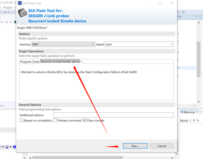

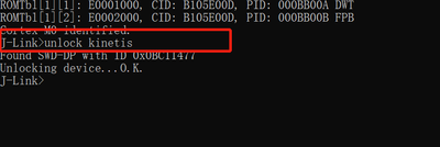

12,165 Views
nxf58904
The way to unlock kinetis via GUI as follow shows
And the way to unlock kinetis via jlink command as follow shows
TIC
12,179 Views
nxf58904
Can I ask which pin you set ?
Do you have a try to unlock kinetis by GUI flash tool in MCUXpresso,or use a jlink to unlock kinetis
TIC
