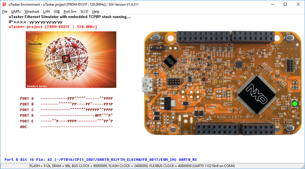

mjbcswitzerland
Specialist V
Thomas
I just checked in a FRDM-KV31F target at the GitHub version.
Mark
The simulation will show:
