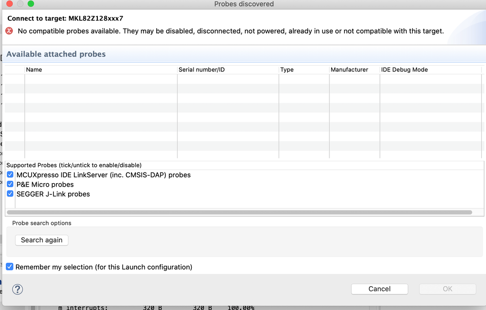

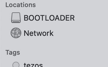

Hello all,
I directly copied and pasted the bin file to the board at that time still can be recongnized as a tty interface.  However, after status led flashed quickly and I unplugged and plugged the cable again, the tty interface has gone.  Also if now I use the Xpresso IDE to flash some other axf to the board.  It would show probe cannot be found.
Anyone knows how to get the usb driver back?  Thanks a lot.
Screen Shot 2020-10-11 at 2.11.27 AM.pngScreen Shot 2020-10-11 at 2.11.27 AM.png
But it still appears as the bootloader driver,

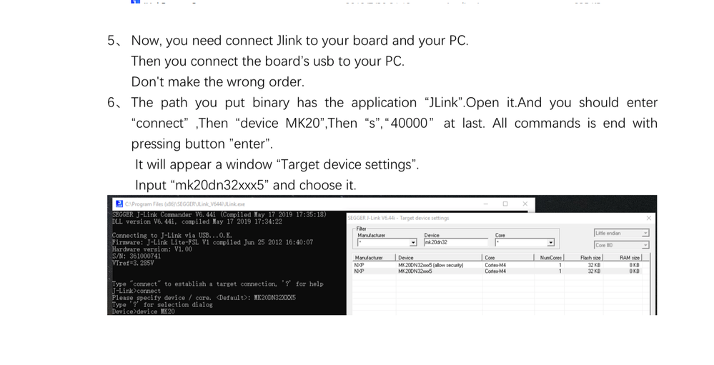

nxf56274
It looks like you firmware wasn't updated. Because the mcu uses old bootloader, but you put the new firmware for him and we do not have the old firmware. So you have to update the bootloader. The attachment is a guide to teach you how to update the bootloader.  You need a jlink to connect to J9.

michshell
Thanks admin.  One quick question on step 5 the Jlink connection basically means to connect the SDA USB port to the PC, am I right?
I was trying step 5 like first connecting the SDA USB port with the PC, after that, I got another cable to connect the other usb port to the PC.
Screen Shot 2020-10-12 at 11.11.34 PM.pngScreen Shot 2020-10-12 at 11.11.34 PM.png
At the moment I got stuck in step 5/6, as Jlink cannot get connected via USB.  I will keep trying different ways.

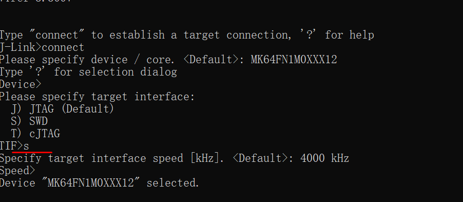

nxf56274
The device you choose should look for the schematic. MK20dn32 is used for k64, not your Board.
You should find 'MK20DX128VFM5'.

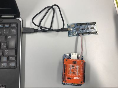

nxf56274
You need another jlink to connect to the board. Not usb. Something like this. This is lpc-link. I use it to connect to the board pin 'J9'.

michshell
Dear Admin,
I purchased a jlink and did according to the instruction but it still could not work out.  My first time to use a jlink so there might be some issue I was unaware of.  Attached are relevant pictures for this time.

michshell
I switch to J19 and got some new error this time.
