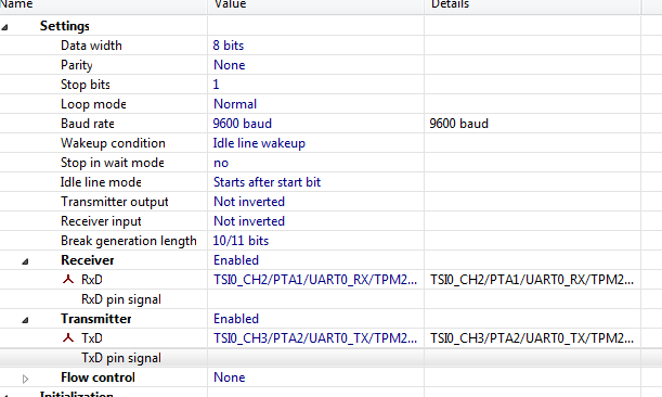

Hello ,
I just get my first Kinetis and I'm trying to initiate serial communication with a Real term.
I start a new project with Processor expert and select the UART0 as a serial_LDD components and  I set all the parameters ( Pin affectation, baud rate , interrupt disabled for polling and automatic code generation).
Then I generate the code and modify the main code with the components example , here below  the code associated  :
With this code I cannot get any communication with my real term and the AS2 seems to return a ERR_BSUY.
Could you explain me what I'm doing wrong and How could I get communication running between my real term and the Kinetis micro.

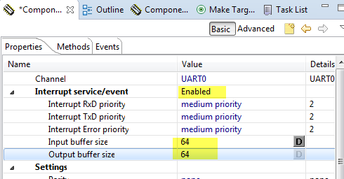

BlackNight
Hi Russel,
enable interrupts and buffers in the component:
That way you can send a block up to the buffer size.
otherwise check the return code/value of SendBlock(): if not ERR_OK, then you would need to resend it because buffers were full.
Or check the number of characters in the Tx buffer first with GetCharsInTxBuf().
Erich

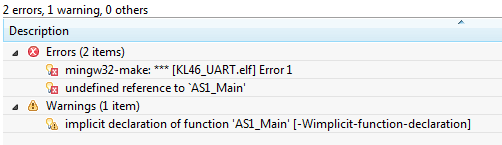

russellsher
Hi Erich
(I'm finally back after being away)  I tried your suggestion to enable the interrupts -- forgive my ignorance, but I can't see the Output buffer size option after selecting enable :
What have I forgotten?
When I enable interrupts and compile, I get this: (no doubt due the incorrect configuration in my uart):
can you advise please? - thanks as always
Russell

BlackNight
Hi Russel,
have you generated code? That AS1_Main is used only if you are in polling mode.
The buffer size should show up. Are you already in Advanced/Expert mode?
Erich

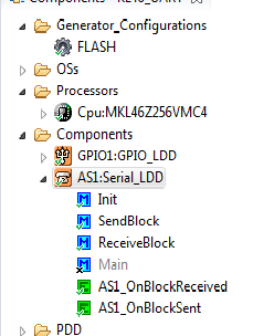

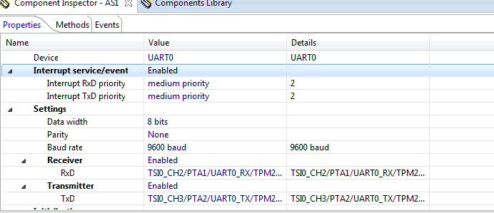

russellsher
Ok - so I hadn't generated code (somehow thought that building would take care of this at build/compile time)
Now that explains why I got the error but I'm still not seeing the input buffer size: Am I using the wrong uart component:
components window shows:
