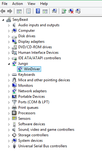

can you see the "PEMicro OpenSDA Debug Driver" on the device manager window after you connected the USB cable to the FRDM board?
If you can see it, the "BOOTLOADER" MSD will appear when connected the cable with pushing the reset switch.

I have installed that driver on my C drive. All of the text logs I have looked in say the driver install was successful as well. When I connect the device, the PEMicro OpenSDA Debug Driver does not show up. Is it a separate driver I need to install?
This is what I see before and after plugging in the FRDM-board. (Even after refreshing the screen).

1) Do you see something under Ports (COM & LPT) in Device Manager?

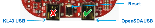

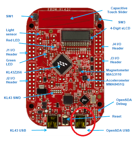

2) The FRDM-KL43Z has 2 USB ports. Which one are you using?

let me confirm one more thing. I think it would be little possible thing but you didn't plug to wrong connector, did you?
