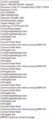

Hello
I'm new in this MCU. I bought FRDM-KL26Z and connected Jlink by cutting SDA (J8 open). It was not successful. LED indicator of Jlink was saying "reset is active on the target". I checked the reset pin of target MCU. It was only 0.9V (/w and /wo Jlink connection). With this, I guess there is something wrong in the board hardware.
Below is the capture from MCUXpresso IDE.
Could you advise ?
Thanks and regards, Daewoong
1,684 Views
nxf58904
Try as follows:
1.unplug board
2.press "NMI"
3.plug-in
4.Download
