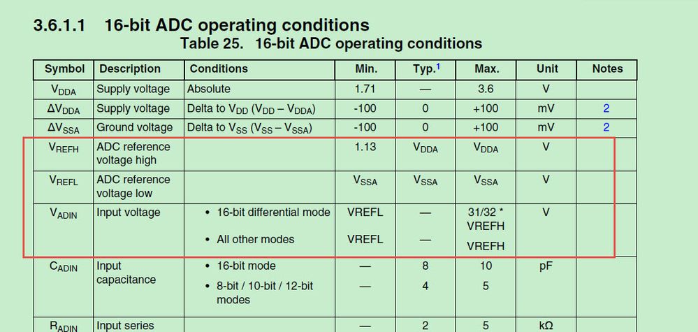

    The KL26 can't accept negative voltage inputs for ADC, you can find it from the datasheet:
  So you should use the external circuit to keep your signal  between the VREFL - 31/32*VREFH.

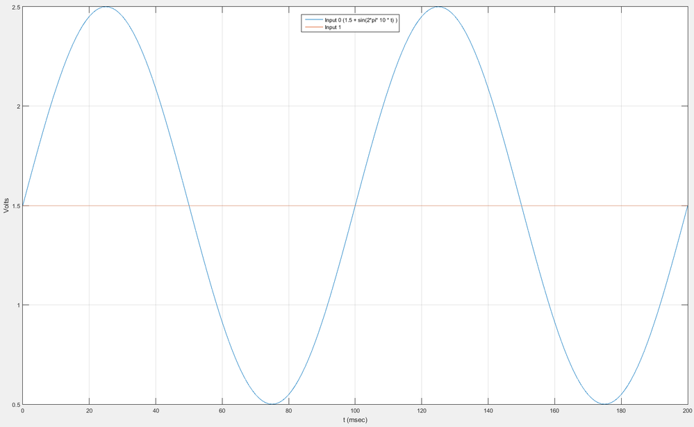

Then, in this case, suppose there is a signal like "input 0" in the picture.
The sine wave is now biased with a DC voltage (1.5 Volts).
"Input 1" is a DC voltage source of 1.5 Volts.
I never used the "DIFF" mode before, so my ideas may have errors.
I know that the 16 bit ADC has sign bits, if I configure them.
Then can the ADC pins can read both "input 0" and "input 1" and use the diff mode
,in order to get rid of the DC component and read it as singed inputs?

    Actually, the sign bit of the ADC data register  is just for the diff mode, because just the diff mode has  a pair of external pins, DADPx and DADMx, when do ADC diff conversion, it actually convert the DADPx-DADMx,  if the DADPx higher than DADMx, the result is positive, if the DADPx is lower than DADMx, the result is negative, then it will use the sign bit.
    Your problem is very simple to solve, you just need to use the 16 bit differential mode, connect "input 0" to DADPx, connect "input 1" to DADPMx, then you will get the diff data of your input0 and input1 in the ADC data register, and it should have the sign bit.
