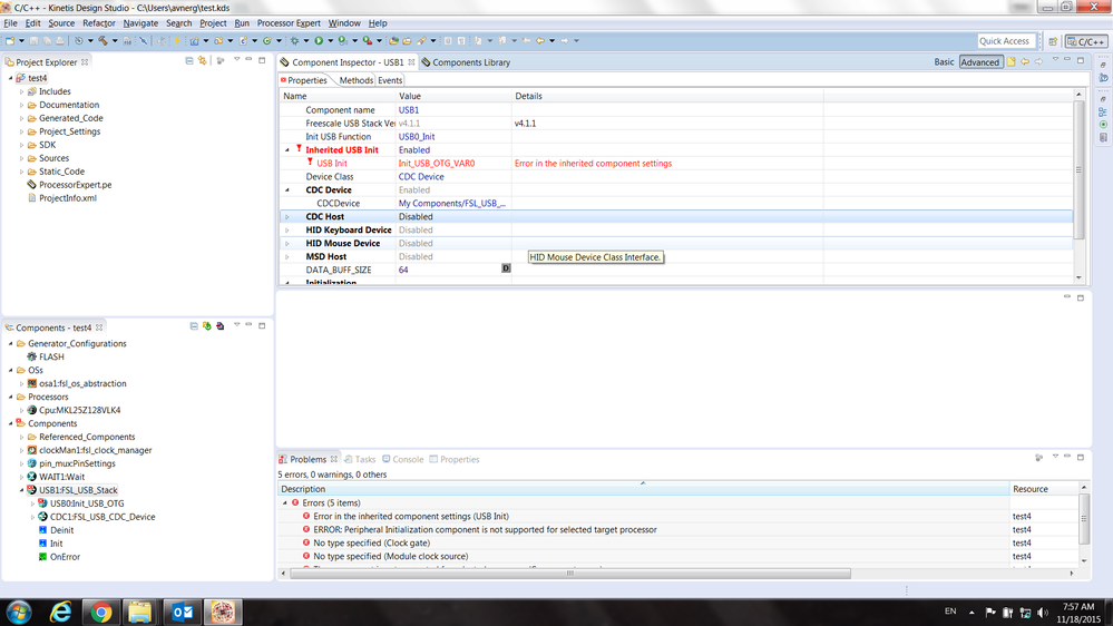

I tried what the tutorial  explained and  I  got stuck rather fast...
I tried searching for the FSL_USB_Stack and the Wait and did not find it...
those are the options  I get when I search processor expert related to usb:
I tried the  various options and got some errors I wasn't sure how to solve (the same thing happens in the CodeWrrior).
can you please guide me a little bit more?
Thanks a lot!
Avner

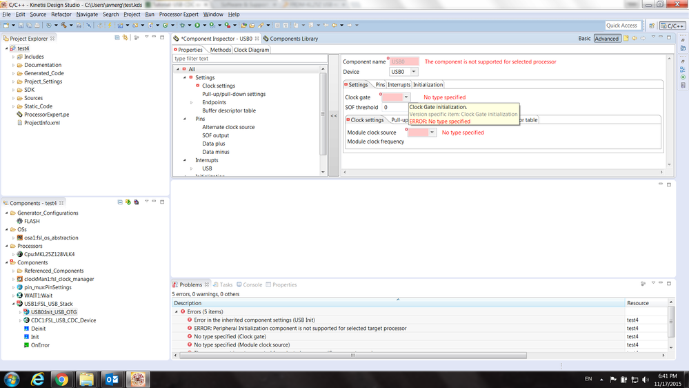

avnergidron
I now get the following:
and there is no options to define in the clock gate and all the other red blanks.
what am I doing wrong?

BlackNight
I believe you have set the wrong Init component for USB. It should be the Init_USB_OTG_VAR0 one:

avnergidron
I switched to no tabs (I was actually searched  for it) and I checked the Init component and it is the right  one:
is there  something else that may cause this?
If it helps,  when I create a new Init_USB_OTG component it does enable me to change those settings...

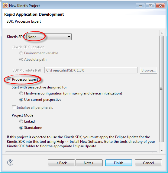

BlackNight
Ah, I see it now: you are using a Kinetis SDK project. The Kinetis SDK is not compatible with these components.
You need to create a project without the SDK enabled.
Erich

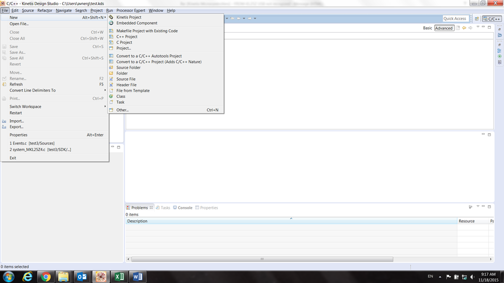

Not sure what kind of project to open (sorry I'm such a Novice:smileyblush:)
The tutorial said: "To create a new project, I select the menu File > New > Bareboard Project" . Those are my options:
what should I choose?

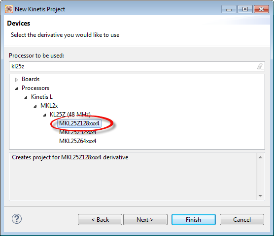

BlackNight
Select KL25Z128xxx4:
Erich
7,518 Views
