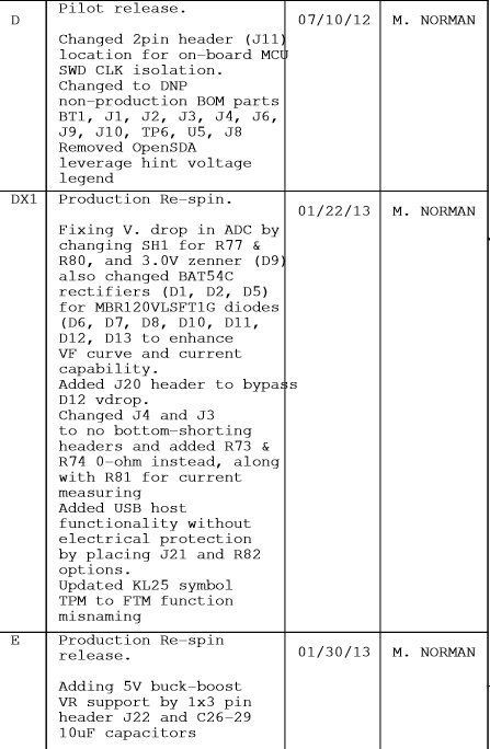

Hi, does anyone have the schematics for Revision F of the FRDM-KL25Z PCB?  The latest schematics I see online are for Revision E. Or, what changes are there from the E revision?

I got this.
Changing C12
from 1uF to 0.1uF
to fix yield issue
thanks

Hi Alex,
the only official available FRDM-KL25Z schematic is Rev E.  I don't have any information for Rev F.
here is the Revisions & Change Log from Rev D to Rev E.
more information can be check from the first page of Freedom Kl25 Rev E schematic
http://cache.freescale.com/files/soft_dev_tools/hardware_tools/schematics/FRDM-KL25Z_SCH_REV_E.pdf
can this help?

In any case, I compared the boards and didn't see any obvious differences, so perhaps it's a minor change.
