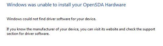

After I copy and paste this firmware to the board via the BOOTLOADER and then disconnect and reconnect the board, windows tries to search for the device drivers and fails to install them. And the usual driver failed to install prompt appears:

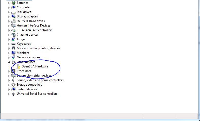

So then I proceed to download and install the PE drivers from this website under Windows USB drivers: P&E Microcomputer Systems and install them on the default location C:/PEMicro, and then I open device manager and this is what it shows:
I then update the "OpenSDA Hardware" driver and I manually select the PEMicro folder, I try with every folder and subfolder and every time windows fails to find a suitable driver for the board.UnableToFindDriver.JPG.jpg

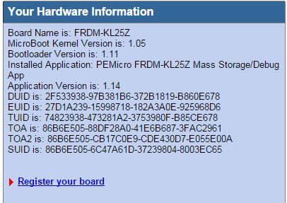

The bootloader version installed on the FRDM-KL25Z is the 1.11
