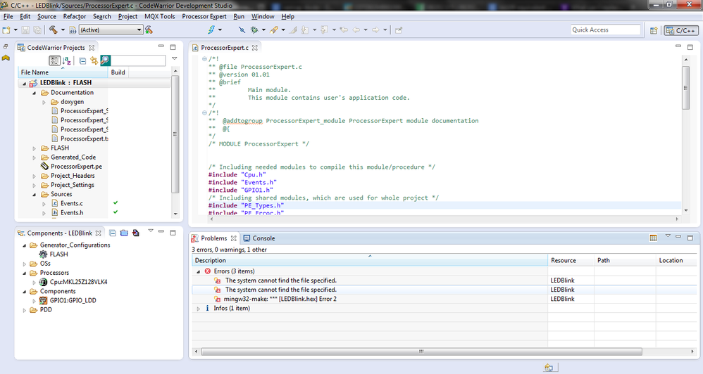

ashokfair
Thanks Erich !
I am frequently getting Error "The system cannot find the file specified path". sometimes its going after clean and Build but now i couldn't clear this error
what could be the reason?
