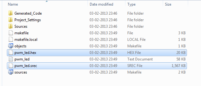

BlackNight
Please verify if you really produce a S19 file (and not something else). I have created many Processor Expert applications, and the S19 file is only few KBytes.
See Optimizing the Kinetis gcc Startup | MCU on Eclipse which produces less than 300 bytes of code.

ashokra
Hi , This in an example project output files. here "SREC" file size is more than 1MB , why two type of out files are here (hex and srec). If i drag the HEX file into open SDA port it working now..

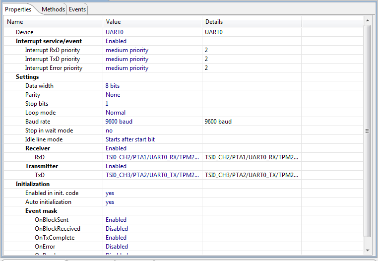

ashokra
Hi Erich,
Finally i done my LED Blinking Project ! This is my code given below..
main(){
PE_low_level_init();
while(1){
      Bit1_PutVal(0);
delay();
     Bit1_PutVal(1);
delay();
AS1_SendBlock(NULL,"ashok",5);
Here i added UART  components. but UART not working.. can you help me..
my configuration for UART is given below...
