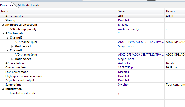

I am using the Typical Example code provided for the higher level component AD1.  I basically followed the One conversion example of all channels, with interrupt service.
I selected two channels to be enabled in the component and selected the pins, but when the interrupt fires off and I command
AD1_Measure(TRUE) then
AD1_GetValue(Values);
only channel 0 shows a value. channel 1 is always 0 value in the variable view.  My code looks at the value as ADC_Value[0] and ADC_Value[1]
What might I be missing?

full project uploaded under TIC 1-1005917641
below is a screen capture of the bean settings.

Alright, I have tried everything.  I put the get value inside the interrupt routine rather then in main, I tried to convert just channel 1, I even tried AD1_Measure(FALSE); to get the second conversion to happen like the typical usage example.  I always get a value in the first element and only 0 in the second element.  Could someone spin the most simple example either polling or through interrupt of getting two channels to convert?

from you code, it seems that the problem could be that you have declared results as array of unsigned ints, but the results are 16-bit and int is 32bit.
Try to use 'word' instead.
You can see also attached simple example.

I still only see one value shown in the debugger for Measured Values, I changed the first two pins to PTE20, and PTE22 which the real application uses.  Can you confirm this project is working correctly.?
