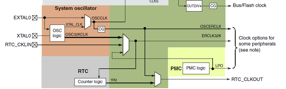

sarastout-grand
Hi Mark,
Thanks for the quick response!
To clarify, I want to run the LPTMR off the external 32kHz crystal that is installed on the FRDM-KL03Z evaluation board, so I think you are correct with your first assumption. I understand that the crystal is connected to the EXTAL and XTAL pins on the KL03. According to the diagram on page 56 of the KL03 user’s manual (Chp.5 Clock distribution), it looks to me like both the OSCERCLK and the ERCLK32K can both be derived from the EXTAL. Correct? I should therefore be able to run either one into the LTPMR, correct? What is the primary difference between the two?
Sara
4,143 Views

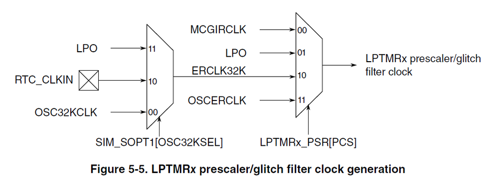

mjbcswitzerland
Specialist V
Sara
I think that this is the diagram of interest for the LPTMR:
In your case it is true that the two possible sources are in fact the same. The signal OSC32KCLK is only present when a 32kHz crystal is used and not when a higher frequency one is delivering the XTAL_CLK.
Mark
