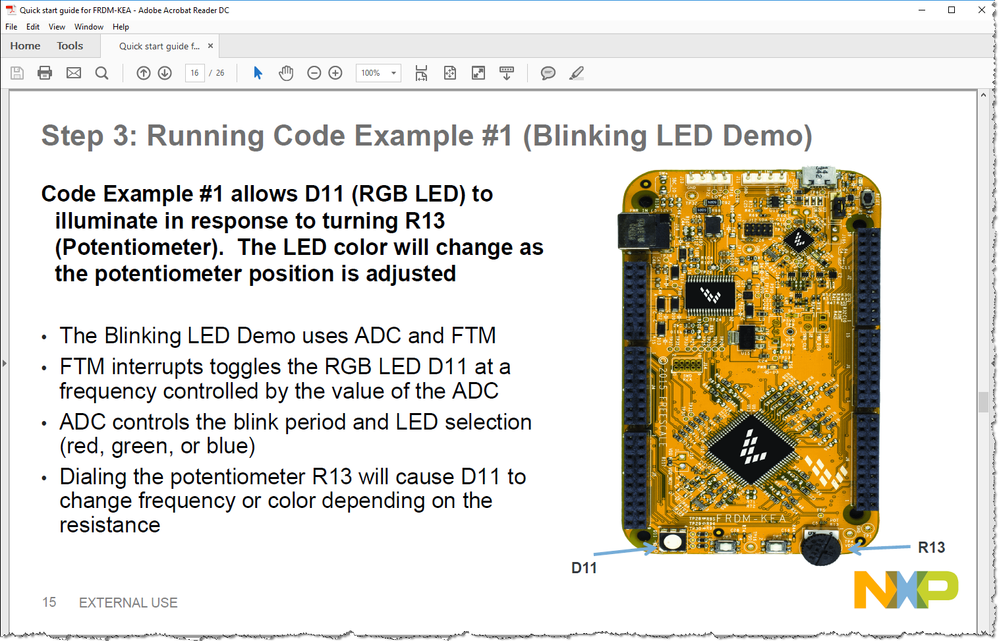

   Is the source code for the demo that comes with the FRDM-KEAZ128 available somewhere? It would be great if I can restore the board after experimenting.

   Are you referring source in Code Project Examples for FRDM-KEAZ128.zip in Quick Start Package v8/Code Project Examples and Sample Drivers (Evaluation Grade Only)/FRDM-KEAZ128/Code Project Examples for FRDM-KEAZ128?
   After checking sources in Lab1 - Lab11, I haven't found source with the same behavior as the out-of-box demo, in which two different demos in controlling the LED are selected by pressing switches. Am I looking at the right place?

I did not find the Out-of-Box Demo project for FRDM-KEAZ128.
But the Lab6_Blinky_FTM_ADC_KEA128 is very similar to Example #1
