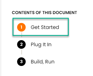

stephanie_m
Could you please help us check the following link?
https://www.nxp.com/document/guide/get-started-with-the-frdm-keaz128:NGS-FRDM-KEAZ128?section=build-...
This will help you with some more details on how to deploy one of the examples.
Also, in the web page you can find in the getting started the different pre-requisites.
Hope this helps.
