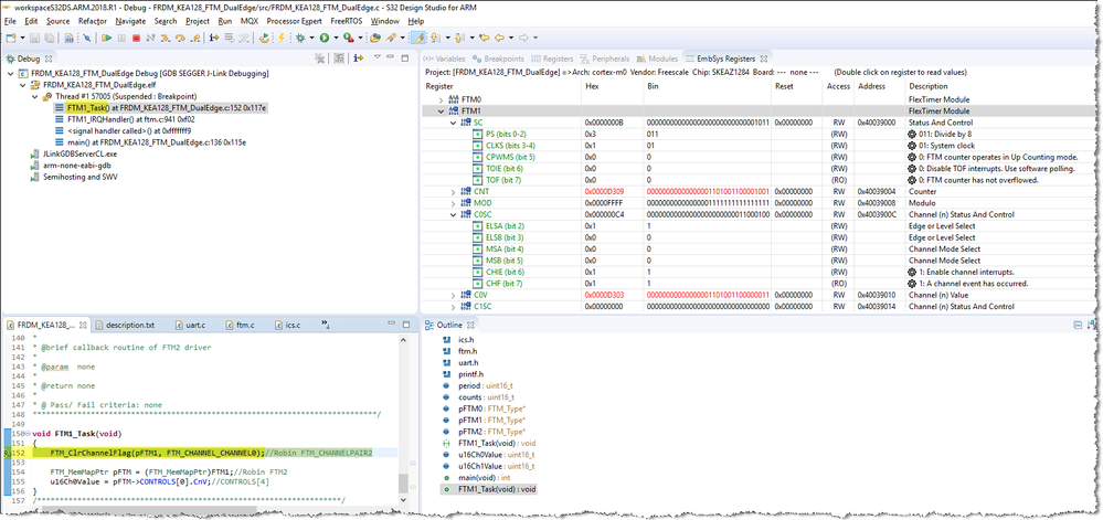

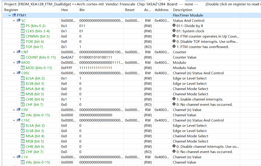

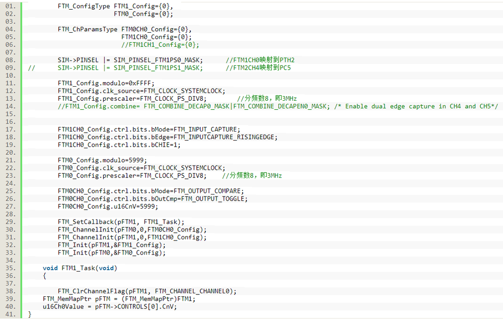

I have modified the API  in Driver Test SW (KEAZ128FRDM_KEA128_FTM_DualEdge), but it can't work.
I use FTM0CH0 as the output source and use the FTM1CH0 as the input capture.
Please help me find the errors in my codes. If provided the Input Capture demo, it's the best.

Hi Yinwei,
Test it on FRDM-KEAZ128Q80 board, I can get the input capture interrupt.
You need connect the pin13 J4 to pin8 J6.
Please check the attached file.

Robin_Shen
You can compare the attached codes with yours.

    Thanks for your help sincerely. I have solved my problem according to your attached file.
