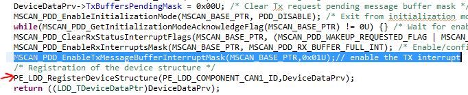

I'm using CANAlyzer to monitor frames and configured it at the same bit-rate, no frames are seen on the bus. I tried with and without 120ohm terminating resistor. From reading this NXP thread https://community.nxp.com/thread/386975 , I learned that PE actually forgets to add the interrupt enable mask for transmitting frames. That explains why the debugger doesn't reach the event CAN1_OnFreeTxBuffer(). After adding the missing line to the end of the CAN1_Init() routine, the debugger shows that the MCU is stuck in the PE_ISR(CAN1_TxInterrupt) loop. This happens during PE_low_level_init() before any of my code is executed (actually setting up a data frame).
I have tried disabling autoinitialize components--so I call the CAN1_Init() function myself and then CAN_Enable() to see what's going on. I tried adding the highlighted line just before setting up the CAN frame doesn't work either. I'm not sure what to do here, I have also tried removing the line (no frames sent, no OnFreeTxBuffer event triggered). When I use loop-back mode, the event gets triggered and the MCU doesn't get stuck in the ISR function.
