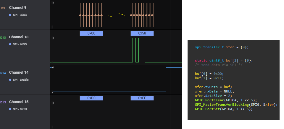

It's been a while since you started the post. I'm having simular issue with KL25+BMP280.
I´ve check the SPI0 regs and they are configured as
1)MSTR bit in SPI_C1 is set, the SPI is in master mode
2)MODFEN bit in SPI_C2 is set.
3)SSOE  in SPI_C1 bit is set, the SS pin will be Low during data transfer, high during interval between two transmission automatically.
But I still see the SS going high between two bytes. In order to that work, I need to configure SS as GPIO.
But I still see some "space between the two bytes, where SS enabling signal would be.
Is there any particular change on SPI0 regs for KL25?AndreVB_0-1647111391121.pngAndreVB_0-1647111391121.png
