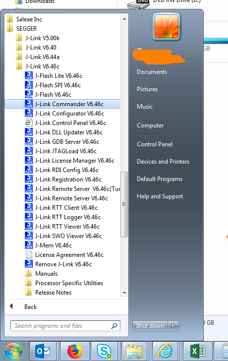

5)Open the JLINK commander window, you can find it from the JLINK driver install path:
Now, follow my steps to connect your board, can you find the ARM cortex M0+ or not?

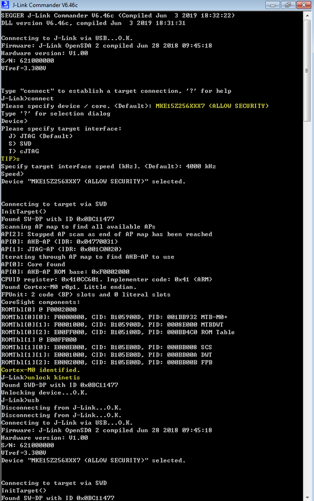

   Please give me the JLINK commander window information when you connect the board, it is very useful to my analysis, you don't need to use the MCUXPresso IDE to connect or download the code now.
  Please share your JLINK commander result.
Kerry

   If it is not working, please share your JLINK commander window after you change the JLINK firmware.
  Please do it, instead of just check the led status, the JLINK commander will help you whether your on board chip is OK or not.

t50papa
I follow your last reply.
Not exist any JLINK Commander Window.
The Board Is not Recognized by PC when Plugged at USB port.
The PC only recognize it when plugged with Reset Button pressed.
