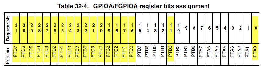

I notice something in your code that I want to emphasize.
In the line:
  // GPIOA PTA0 and PTB3 are outputs
  GPIOA->PDDR = 0xffff0801;
You are configuring the pins showed in the picture below as outputs:
According to the reference manual the  Channel 0 of the FTM2 you are configured by default is the PTC0, which is already configured as output. You can select between PTC0 or PTH0 to be the FTM2_CH0 input in the SIM_PINSEL[FTM2PS0]. I think that is probably causing that strange behavior.
To configure just PTA0 and PTB3 as outputs you can write:
  GPIOA->PDDR |= (1<<0)|(1<<11);
Hope this information can help you.

davetelling
Adrian,
The PTC0 should be an input by default, if I understand the reference manual, and I don't change that, I leave it at 0. PTB3 is being used as an output for my test program, and it does, in fact, generate an output.
What I finally found that worked is that I have to clear the flag bit in the CnSC register when the capture interrupt occurs, otherwise, it apparently continually tells the system that CH0 is constantly interrupting.
