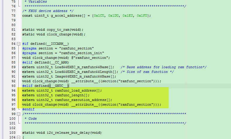

dhanapal_rajend
Hi Kerry,
Thank you very much for your reply. We are using KDS IDE  3.2.0. bubble_frdmk82f project with your source is not compiling. I am getting compilation error.
- undefined reference to `ramfunc_length'
- undefined reference to `ramfunc_execution_address'
- undefined reference to `ramfunc_load_address'
Previous source is compiling successfully.
R.Dhanapal

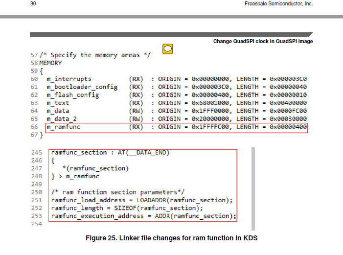

kerryzhou
Hi dhanapal rajendran,
    Thanks for your updated information.
    You can try my attached bubble file on your side at first, download the .sb file to your frdm-k82 board, check whether it works OK or not on your side. It already works OK on my side.
   About the KDS version,  please note these points:
1.  bubble.c
You can define the __GNUC__ on your side, then the according variable will be defined.
2. Please modify the linker file
Actually, you can refer to Kinetis Bootloader QuadSPI User's Guide.pdf in the doc folder, chapter:
7 Change QuadSPI clock in QuadSPI image
Then you can build the KDS project.
Kerry

kerryzhou
     Really so sorry for my later reply.
    If you want to run the app, and boot it from the qspi, just modify the linker file is not enough.
   About the detail steps, please refer to the document Kinetis Bootloader QuadSPI User's Guide.pdf, which you can find it from FSL_Kinetis_Bootloader_K80_Tools_1_0_0, this document give the details step about how to modify a normal application code to run from QuadSPI.
   I also attached the SDK code as the app, but I use the led_blinky. I already change the clock to PEE, and modify the code, after the clock is switched, you will find the green led is blinky.
   You can check it on your side, I just modify the IAR project. You can try it at first.
    I also attach the generated sb file.
   But the bubble download also have problems on my side, I need more time to check it.
Kerry
