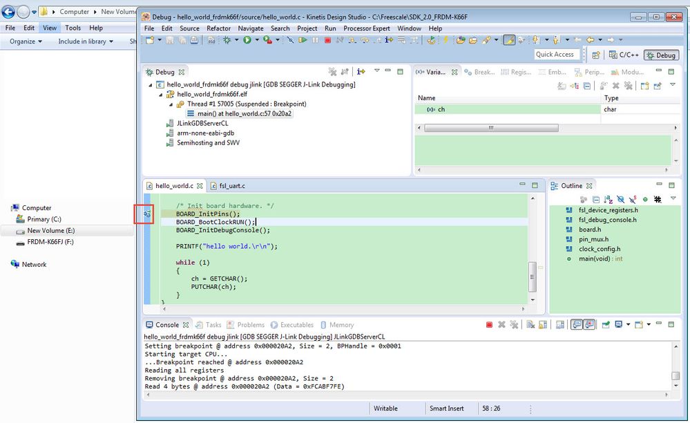

I'm not able to flash the code in FRDM-K66. I'm able to access BOOTLOADER and update the JLink firmware. (03_OpenSDA_FRDM-K66F.bin)
After this, board is enumerated as a drive "FRDM-K66FJ" and when I try to load the program from KDS3.0 it fails.
debug log is attached.
Please help.

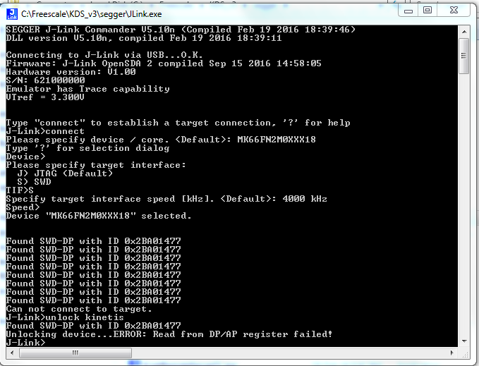

Looks like board is blocking the mass erase, since in J-Link commander it is constantly showing this error.

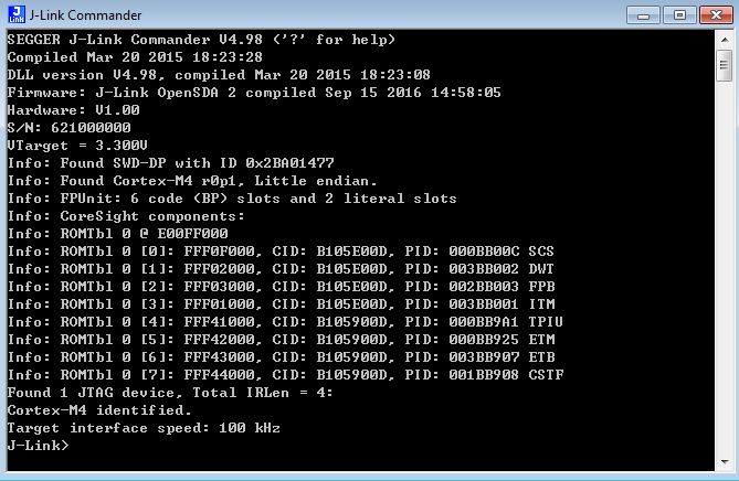

   It seems your hardware can't connect the core.
   Actually, you can use the JLINK Commander to check it directly, you can find the JLINK commander in the JLINK driver.
   This is my JLINK commander interface result:
From your picture, it seems your board can't identify the core.
 Did you do the flash secure before?  Besides, did you modify the board's short block?
Now, use my attached JLINK firmware try again, and enter in bootloader mode, update the JLINK firmware again.
After the firmware is updated, then use JLINK commander to check the board, whether it can find the core?

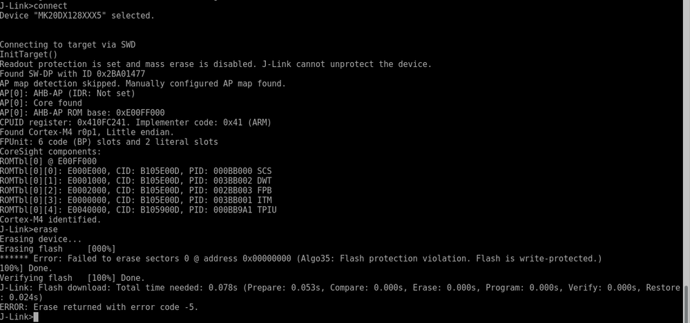

nick_ng
Hi Kerry,
I got the same issue on my K66F board, is that a way to unlock it? unlock kinetis  doesn't help.

     From your picture, it seems you are select the MK20, please double check your board, do you connect the on board K20 chip or the K66 chip? Now, what the function do you want to realize, do you want to update the MK20 debugger code?

   About the K20 chip, I find from your picture, you are just select the MK20 chip, but you need to choose the device as MK20XXX_(ALLOW SECURITY). Then after you connect it, in the JLINK commander, you can use this commander to do the mass erase:
unlock kinetis
Then you can firmware your chip again.
Please try it again.
