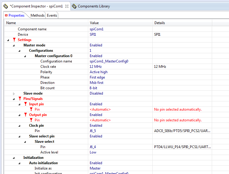

Using PE, I have added a KSDK fsl_spi component to my FRDM-K64F based project.  I can see from the schematic that I should configure the SPI pins as follows. . .
CS - PTD4 (J6 pin 4)
SCK - PTD5 (J6 pin 5)
MOSI - PTD6 (J6 pin 6)
MISO - PTD7 (J6 pin 7)
The MK64FN1M0VLL12 has three SPI ports available, and again from the schematic I see that only SPI1 can be configured to use this pin arrangement.
Here's where the fun begins.  PE allows me to select J6_4 for the select and J6_5 for the clock; but, it will not allow me to select anything for the data pins.
There are no options available in the drop-down boxes (other than <Automatic>).
I am at a loss.  I have attached my project to this post.  Anyone have any suggestions?

Did you disable the filter for the Processor Expert projects, if not, please select the filter and check the component options you will see that only the fsl_dspi component is available to be used with the K64 device.
Hope this information can help you
