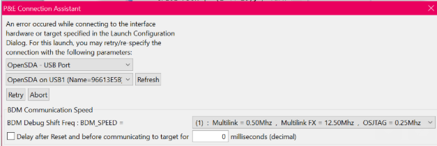

Hi, currently for my class, I've been closely following our installation instructions for our K64F and Kinetis Design Studio app, but the nearly last step involves installing the
DEBUG-FRDM-K64F_Pemicro_v108a_for_OpenSDA_v2.0.bin
After pasting that into the  MAINTENANCE, the window will close, and then my board will show a simultaneous red and green light. (This is in Windows 10, which may or may not be part of the problem). That's the main problem.

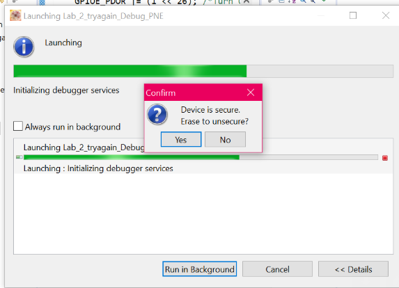

Obviously something was wrong, but just to make sure, I tried to go ahead and do a sample code in the Kinetis Design Studio. After doing the debug configuration, and clicking debug, it'll run to ~halfway and then ask me to erase:
image.pngimage.pngimage.pngpastedImage_1.png which I'm a little worried might do something weird, so after clicking no to multiple pop-ups:
pastedImage_2.png and then finally:
pastedImage_3.png will pop up.
And so finally at this point, after going through multiple questions and pages, I'm at a standstill.

When flash is under secure state , it can't program.So when it ask you to erase it to unsecure ,just click yes. it will be ok.
