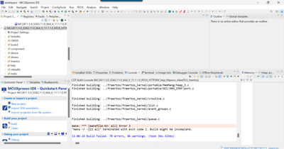

Celeste_Liu
Hi Christir,
I tried your testing project. However, there were a lot of error reports. Could you please check it and send us a correct project again?

a8Chcx
Contributor V
Hi Celeste,
I tried to compile the project again and works fine.
Please check the debug directory and there is *.axf file that is generated today.
I am using "MCUXpresso IDE v11.5.0 [Build 7232] [2022-01-11]" and SDK2.10.0
You need to set "LWIP_DNS=1" in preprocessing because I am using name conversion function.
Christie
